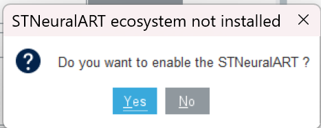

2025-05-26 1:34 AM
When activate X Cube AI and select Validate template, a window popped up asking me to provide the STEdgeAI-NPU package. Do you know how to solve this? Thanks!
