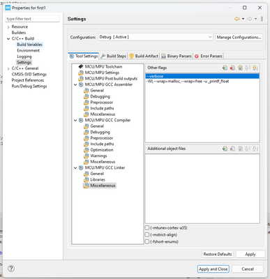

First set exactly that in C/C++ Build, settings, Miscellaneous:
Make sure for the second one to put blank space after the commas:
-Wl, --wrap=malloc, --wrap=free -u _printf_float

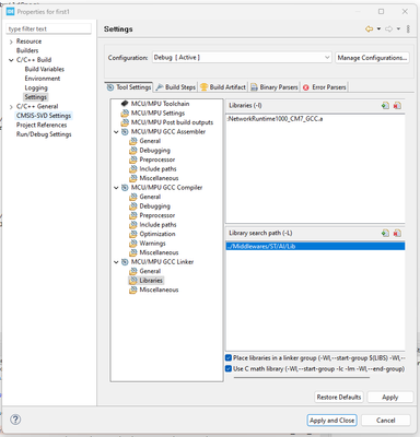

Then in Libraries, make sure to have that:

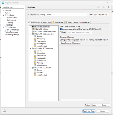

In toolchain, select the first option:

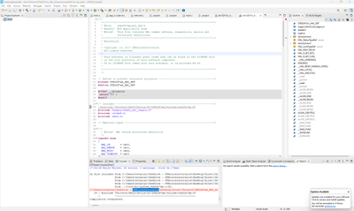

Then build. You will still have errors:
Comment this line:
(double click on the errors and it open the files)

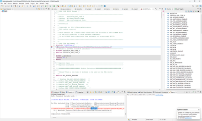

And this one:
(Find the other error and also double click)
