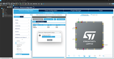

Then i tried to open that network window... but before that a small window opened which showed configuring usart3 and it got stuck at 70% for very long time... i tried closing the app and disconnecting, restarting pc... but the same thing is happening... i shared a screenshot of where it got stuck...

I am sharing the screen record of what i did from start to end... please check it and tell me what is the thing that i need to do....
and also i shared the screenshot of the error...

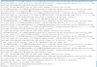

There are soo many errors and warnings...
I think by default, nucleo-h753zi board's stlink is directed to usart3??
but in my connectivity tab at cubeMX, usart3 is not even available... i am not even trying to enable it... please try to help.... it is fine until validation on desktop.. but when i try to build and compile... it is not happening...
