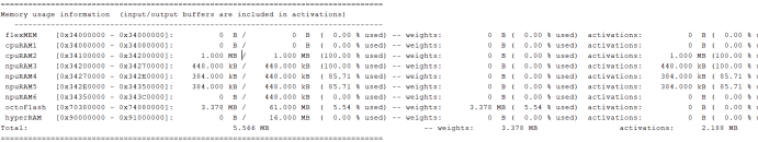

Initially, I suspected this model’s weight/activation size was too large for RAM, causing the NPU to fail loading. But I later tested an even larger model (with greater weight + activation usage), and it validated successfully. Thus, “memory overflow” seems unlikely.

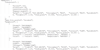

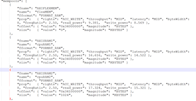

  4. How should I edit the .mpool file—especially RAM bank assignments (AXISRAM1, AXISRAM2, npuRAM3–npuRAM6)?
    • In ST’s official example projects, some do not use AXISRAM1 or AXISRAM2 at all (all activations go to NPU SRAM banks). Others use AXISRAM2 but not AXISRAM1. Yet others distribute activations across cpuRAM2 (CPU SRAM) and npuRAMx.
    • What criteria does ST use to decide which RAM bank holds which activation buffers? If I want to manually adjust .mpool, should I base it on each layer’s memory footprint or concurrency? Is there a reference document or guidelines for this assignment?

  4. Guidelines for .mpool assignments (RAM bank usage)
    • How does ST decide in example projects which CPU or NPU RAM banks to use?
    • If a given model’s activations overflow certain NPU RAM banks but CPU RAM has free space, how can I direct some activations to CPU RAM in .mpool?
