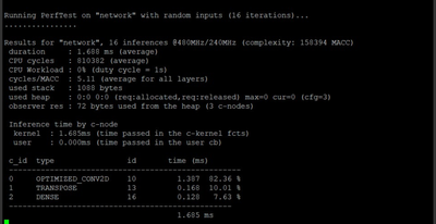

Hello, actually i did exactly the same process as u said...
and i got above output on putty..
can you please please tell me what to do next with MX or IDE file.... please... it is really urgent

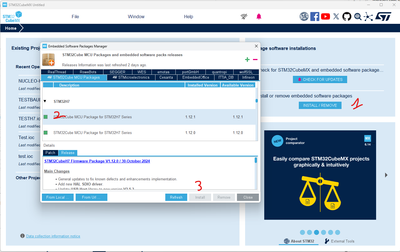

for the include error, I think it happens if you don't have installed the STM32H7 software package:
For your other error, I really think there is something wrong with your setup of CubeMX and/or X Cube AI.

Concerning your putty output, it works as it should.

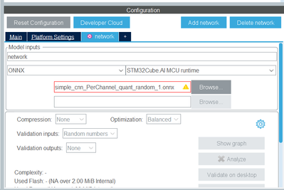

mam... actually i followed your process that told earlier to use st edgeai dev cloud... and downloaded .mx file...
but it is showing like this..
it is not allowing me to analyze and all... what to do mam please confirm

Hello @Pinagadi_Meghana ,
Unzip the folder from the MX zip file then open the .ioc file.

In the zip folder you got from ST Dev Cloud, you should have a whole folder, with the ioc file, the model and other things.
You need to unzip everything and then open the ioc file.
If you still see the error in CubeMX, simply click browse and select the same model again.
I don't understand what you want me to do.
Your error here is just that CubeMX does not find your model.
Simply click browse to add it again...
