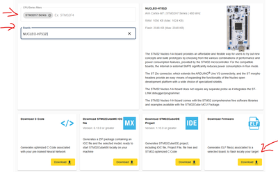

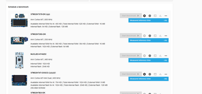

Can you try to use the dev Cloud instead: Session - ST Edge AI Developer Cloud
First try to benchmark it on the STM32h7 Disco or any other powerful board) and tell me if you get an estimation of the inference time.
Then in the last step,
If this works, you can download the MX or IDE project to have the sources instead of the .elf firmarwe.

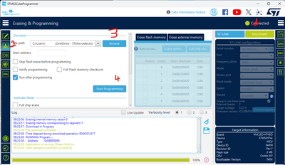

After downloading .elf file... how to open that in IDE ....
Can u please send screenshots from start to end(like u have done before).... please....
2025-03-11 1:27 AM
Hello @Pinagadi_Meghana ,
You need to open it with STM32CubeProgrammer:

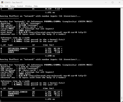

Then if you open Tera Term for example, select the right COM Port and set the baudrate to 115200, you should have the results of inference with a random input:

2025-03-11 5:06 AM
Is this the end output i should get???
there are no accuracies... so i got doubt....
please clarify
2025-03-11 6:44 AM - edited 2025-03-11 8:49 AM
Hello @Pinagadi_Meghana,
Yes, there is no accuracy because this code only does the inference with a random input (and this random input has no label, so you don't have an accuracy).
With this we at least have confirmed that your board and model works.

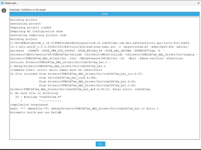

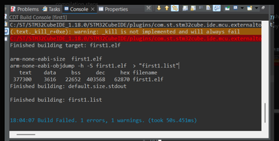

I am getting one error and one warning....
It is preventing the build...
PLease tell me the solution...
i tried implementing kill in syscalls.c under core>src multiple times...
But how many ever times i did that and saved... after i click clean and build... it is showing that error and when i recheck the file... syscalls.c file which i created earlier is present anymore there... I tried and failed multiple times....
What is the problem????
(BTW i dont use any kill function...)
