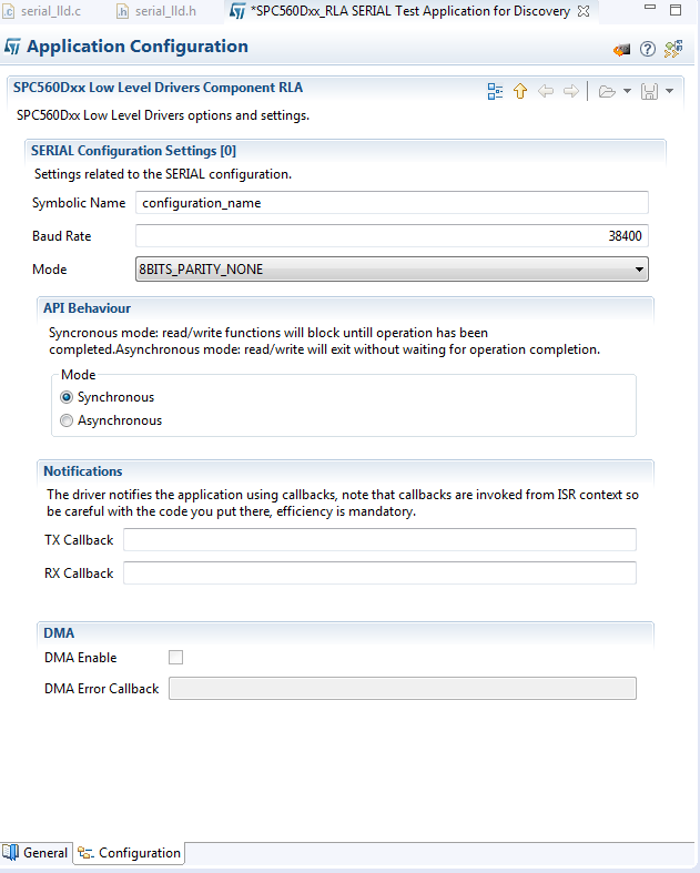

I'm using SPC560B54L5 Discovery board.
I'm trying to get serial communication to work at baud rate 115200. And it works well with other baudrate like 9600,38400 and 57600.

I imported sample code SPC560Bxx_RLA SERIAL Test Application for Discovery.

This test application is set at 37600
Could you send me your serial configuration ?
Did you use Synchronous or Asynchronous ?
Best regards
