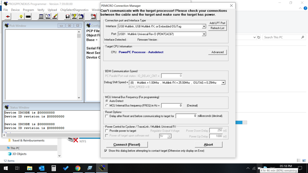

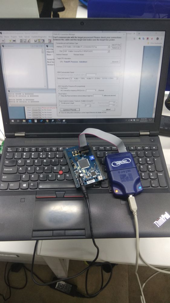

I'm having PEMicro USB-ML debugger and try connecting it with SPC560B-DIS board.
But I'm not able to connect with the target. I could able to see both target power and USB power glowing in the USB-ML hardware.

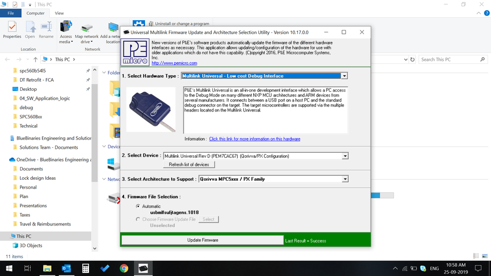

As well, I updated the PROGPPCNEXUS firmware. Still not resolved. Please help me over.

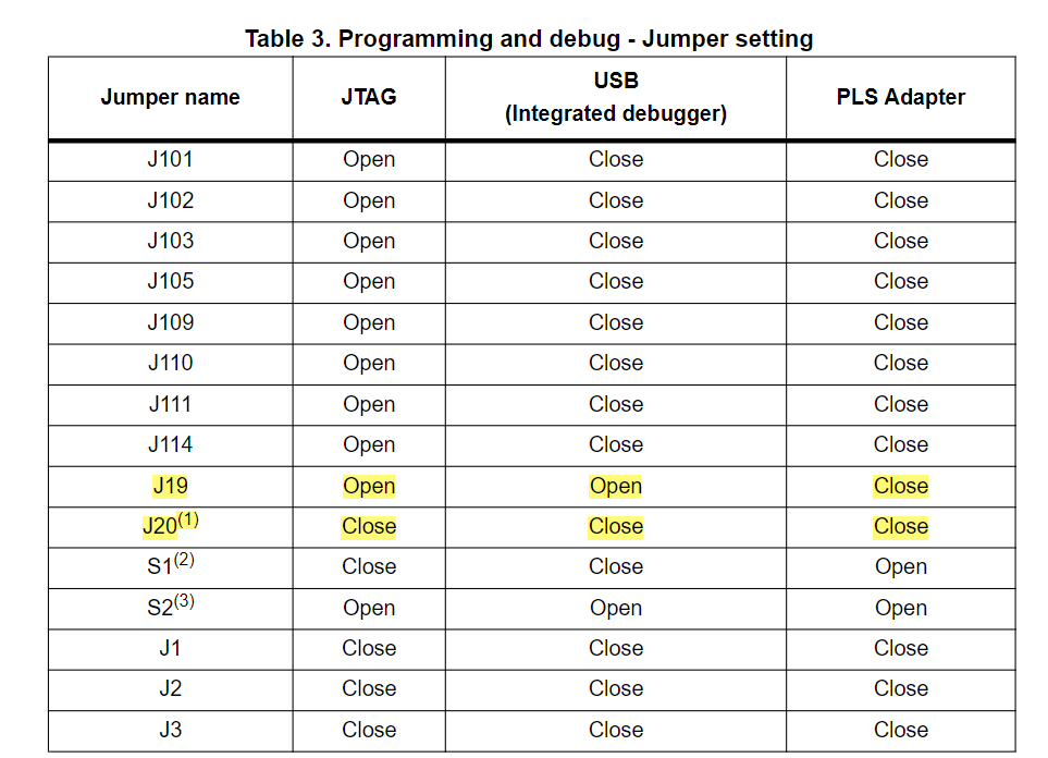

Have you checked the jumper settings of Table 3 chap 2.4 of UM1672 SPC560B-DIS discovery board

I checked it, so, what I have to do with J19 & J20 (soldered jumpers) for connecting external debugger?
if it is working for integrated debugger, no change in that jumper configuration should do fine, but it is not. So need help on this.
