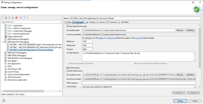

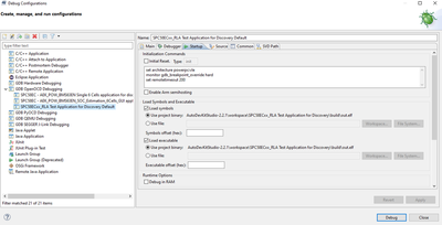

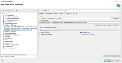

2. Then I moved to openOCD to test (already uninstalled Pls driver and Install UDESTK driver instead), I got an error message: "Illegal instruction fetched at address 0x400a8030. Memory corrupted or target reset?". Those pictures below reveal the error message and all the debug config setting that I config in my project:
Driver installed and Debug config:
