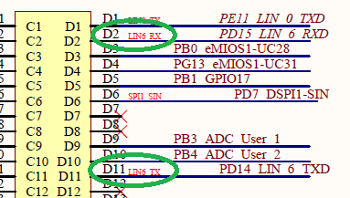

2) Let's look to your connections
There is a big 4*37 connector X9 on the side of your board
each pin named vertically with a character among ABCD, and horizontally with a number from 1 to 37
Do you confirm you connect to the other board using pins D2 and D11 ?
SPC584B LIN6 TXD D11 => RX on other MCU host
SPC584B LIN6 RXD D2 => TX on other MCU host

2022-03-17 3:36 AM
Hi sir,
Yes sir I connected this LIN6 only. big 4*37 connector X9 D1 and D11 pin connected to other MCU.
Thanks
Ravi.S
