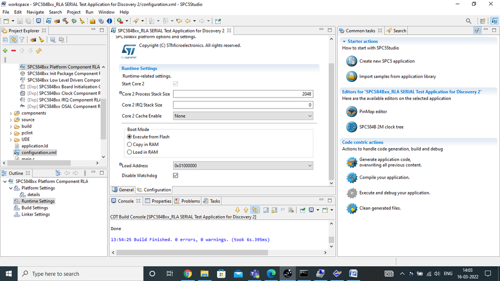

2022-03-16 1:34 AM
I done this steps sir not forgot .
I attached the screenshot for your for your reference.
2022-03-16 2:30 AM

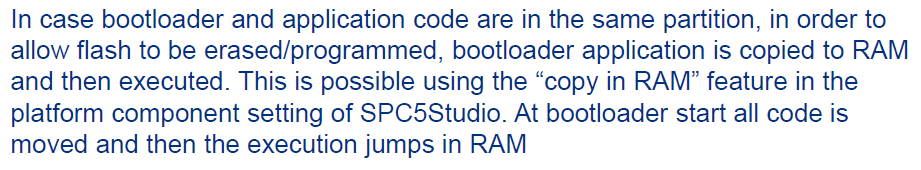

Thank you for your confirmation,
Looking deeper in document and in code, It seems to be the normal behavior.
It is explained in document in step3:
MCU must be restarted after programming to enter into new program, because the jump to new program is not called at end of programming.
