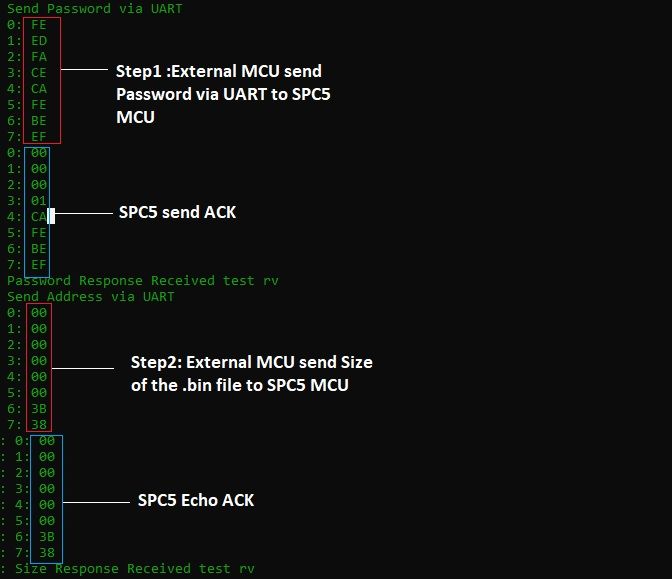

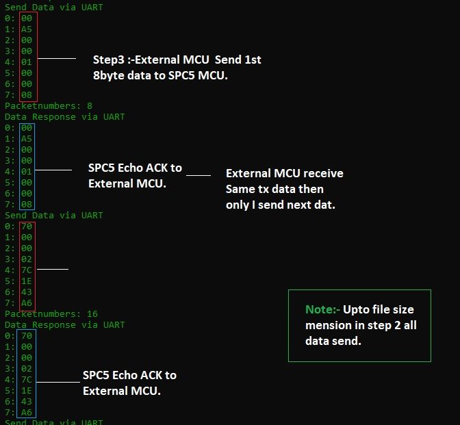

Hi sir,
I print data send from External MCU and send screenshot for your reference.
Host MCU send 8byte at a time
Thanks
Ravi.S

Hello Ravi,
did you try with LIN_0 configuration ?
what is the size of your own Applicative binary (multiple of 8 bytes) ?
