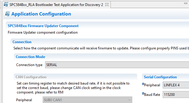

2022-03-11 1:54 AM
I suppose you want to flash your program via USB/uart
Then you need to configure the connection in SERIAL instead of CAN
and use peripheral LINFLEX_4 at 115200Then in the PINMAP wizard, you have to configure the PIN 113 (port PA[0]) in input LIN4_RXD
On PC tool side, also use 115200 baud rate

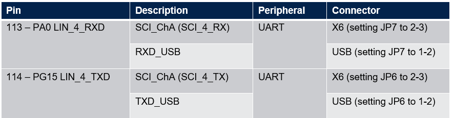

2022-03-14 12:52 AM
it also needs to configure pin 114 in with LIN4_TX because the embedded firmware updater must answer to PC flash loader:Best regards,

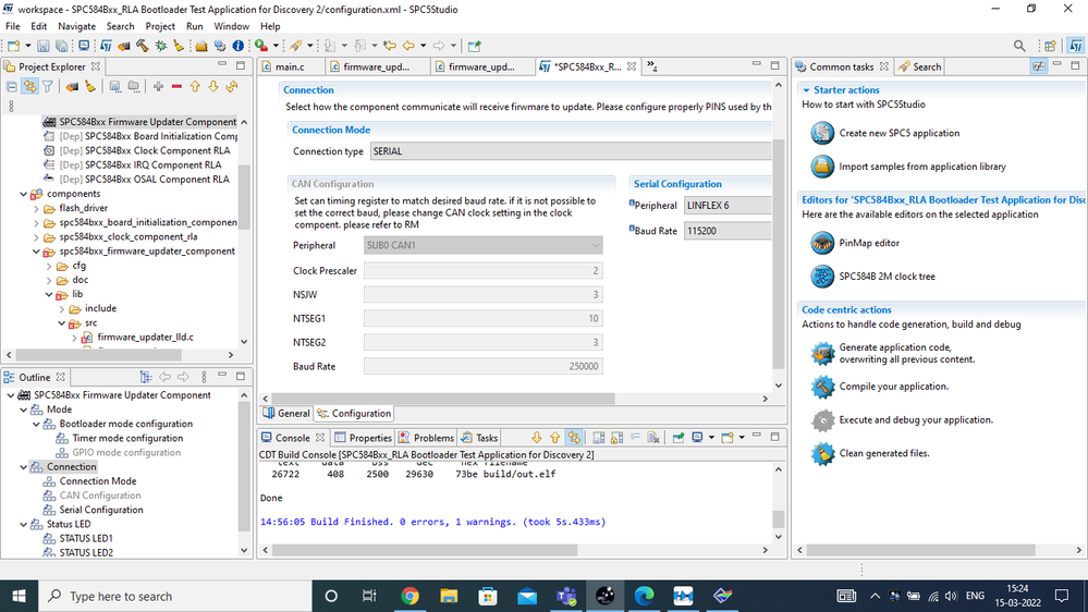

2022-03-15 2:58 AM
Hi sir ,
Thanks for your replay
Sorry for the late reply
I already dune everything above you mentioned but code not jump to latest code .see my configuration on below screenshot

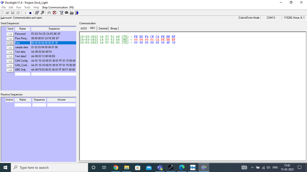

Then while debug I restart the code and I put the breakpoint into inside updater_jump() function .pointer coming to inside the jump to function but new code not executed.
Problem 2:-
I loaded bootloader code into flash (Execute from Flash -0x00FC0000).
Run the code first step I send password from other controller I got response from SPC 5 MCU.
Then I send Size from other controller I am not getting any response from SPC5.
I fount issue with flasherase function.In this function working fine while debug mode but run from flash code stuck into this flasherase function .
I attached screenshot for your reference
you have any idea pls let me know.
Thanks regards
Ravi.S

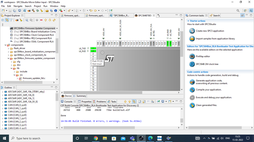

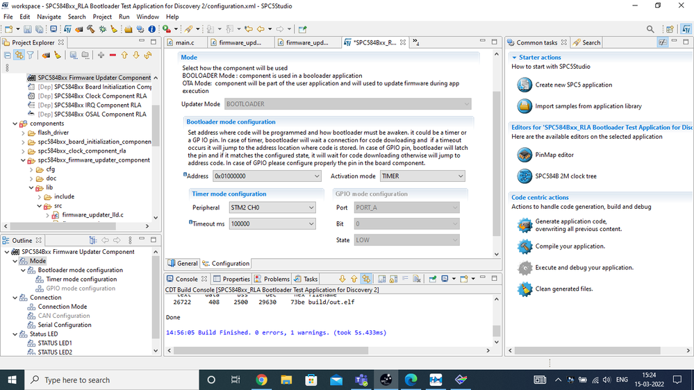

2022-03-15 3:13 AM
on your first image, I recommend to choose a timout of 5000 ms
on your second image, choose LINFLEX_4
on your third image, configure pin 113 and pin 114 on LINFLEX_4

2022-03-15 3:18 AM
Hi sir
That also I tried I am facing same issue.Ok I will change.
If I use LINFLEX_6 it make any problem sir.
LINFLEX_6 make any problem tell me sir then i will change to this pin .

2022-03-15 3:24 AM
There is no issue with LINFLEX_6,
but the UART/USB is connected on LINFLEX_4 on this board:so if you want to flash with USB, you need to use LINFLEX_4

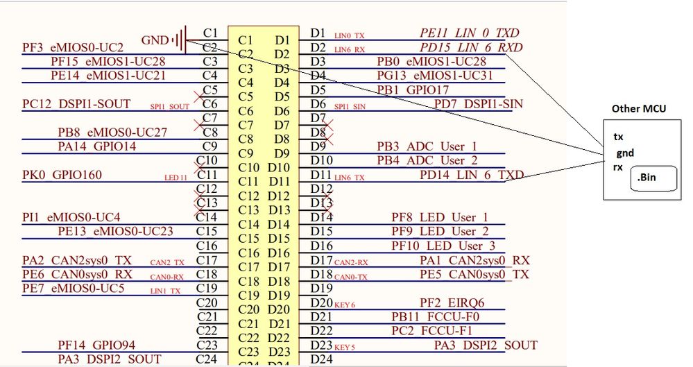

2022-03-15 3:41 AM
HI sir
Thanks for your replay .
I want to flash code from other controller via UART .If I connected LINFLEX_6 to my other controller then my setting is Ok right . I attached the picture for your reference.
My aim is
I want to upload spc584b-disp board via Uart from other MCU .
Thanks regards
Ravi.S
2022-03-15 3:53 AM
I got it,
you don't use PC tool connected to USB, but another MCU is connected to LINFLEX6 in serial mode to flash the SPC584B.
