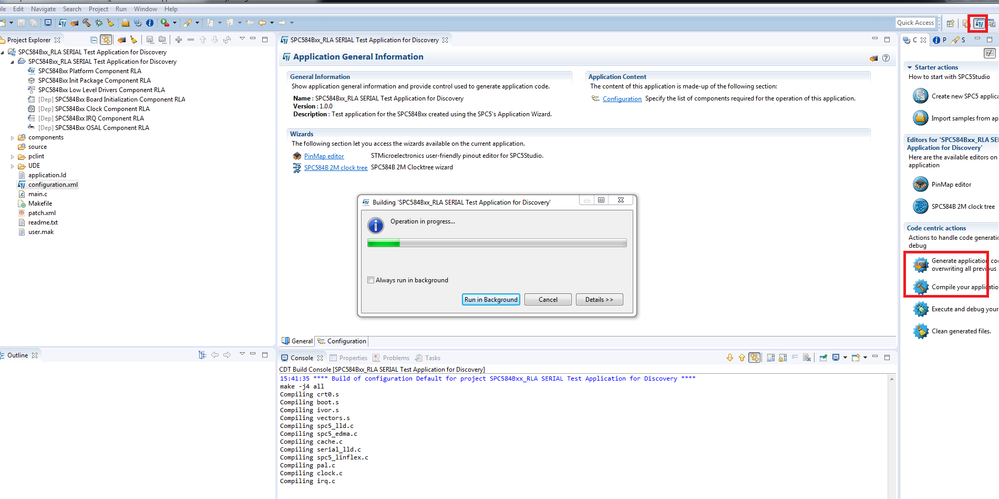

Hello ,
Strange to see that there is an error on Git Icone
org.eclipse.swt.SWTException: i/o error (java.io.FileNotFoundException: C:\Program Files\Git\mingw64\share\git\git-for-windows.ico (The system cannot find the path specified))
at org.eclipse.swt.SWT.error(SWT.java:4533)
I recommend you to switch back into SPC5Studipo Perspective and use the button generate and compile button
(Cf Screenshot)
Best regards
Erwan

Hello ,
(Cf Screenshot)
Best regards
Erwan

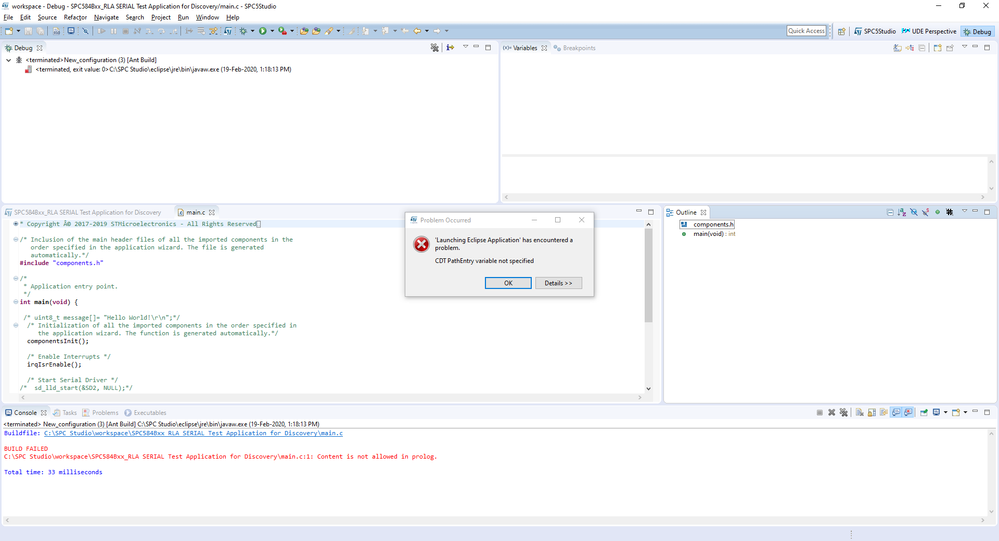

2020-02-18 11:54 PM
I did the same thing as you explained in above screenshot still i am getting an error that launching binary failed and CDT path variable is not specified as showed in the screenshot which is shared by me now.
