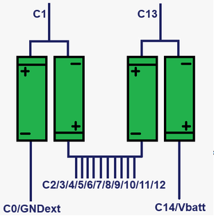

As can be seen from this pic (previously shared):
IsenseP/M are not mentioned.
In the correct HW configuration these two pins of the BMS connector are floating (not connected to anything). Connect just C0 to GND.
Anyway, this should not affect BMS behavior. (IC is waiting for SPI configuration, if not configured or kept alive, D2 switches off after a configured time)
