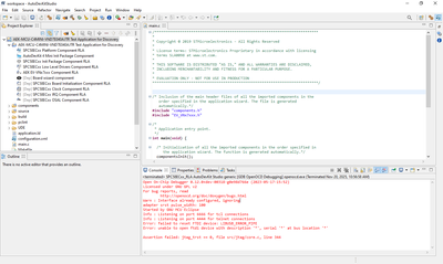

I’m setting up an AEK-MCU-C4MINI1 board and I’m unable to get a working debug session through the board’s mini-USB (P2). I’ve read the user manual, followed the bring-up steps, and tried several configurations, but OpenOCD never manages to see the device over JTAG.
-s "C:\AutoDevKitStudio-2.6.1\openocd\scripts" -f board\spc58xc_dis.cfg -c "transport select jtag" -c "adapter speed 50" -c "reset_config srst_only srst_nogate connect_assert_srst"
Open On-Chip Debugger 0.12.0+dev-00318-g0e98d766eadapter srst pulse_width: 100adapter speed: 50 kHzInfo : Listening on port 3333 for gdb connectionsError: JTAG scan chain interrogation failed: all onesError: spc58xc.tap: IR capture error; saw 0x3f not 0x01Error: no IDCODE present on deviceWarn : target spc58xc.cpu examination failed...Error: Connect failed ... 'gdb' connection rejected

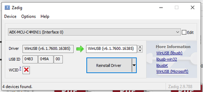

Driver mapping via Zadig:
Interface 0 → WinUSB (Microsoft) (also tried libusbK)
Interface 1 → USB Serial (CDC) (shows up as COMx)

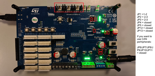

After completing the installation, please make sure that the jumpers of your AEK-MCU-C4MINI are configured as follows:

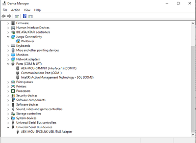

Thanks for the reply, it helped a lot in the installing of drivers.
In device manager i can see one as USB JTAG adapter, which was not available before.(pic uploaded)
I followed all the steps and still i am not able to debug or flash the code to the Mcu.

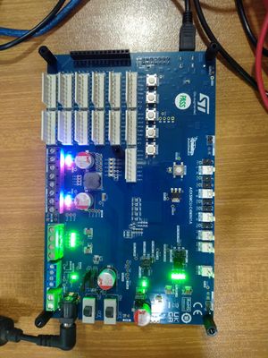

i have given a 12 v to mcu and connected via usb mini b with my laptop.( these are the hardware setup)
i am using the sample project from the auto dev kit studio- AEK-MCU-C4MINI- AEK_POW_BMSCCTX_2_nodes_chin_GUI_application for discovery.
I have connected 8 cells in series with the BMSCCTX with C0 to C8 and gnd. But my code is not writing in the mcu.
I will attach some pics for your understanding and hope you would provide me with a valid answer.

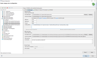

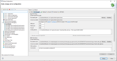

i have issue with run and debugging i have also updated the debug configurations! still i am getting error
2025-11-19 5:47 AM - edited 2025-11-19 5:55 AM
From the screen I see that your "config option" of the debugger tab is different with respect to the one in the documentation.
You should have just:
-s C:\AutoDevKitStudio-2.6.1\openocd\scripts -f board\spc58ec_dis.cfg
Make sure all the steps described on the guide I shared are followed @daynialkhan
Moreover, we cannot assure "Zadig" is installing the correct drivers.
I suggest the manual procedure,

2025-11-19 9:56 PM
I have followed AEK-MCU-SPC5LNK_QSG_reduced.pdf step by step! but screenshot can be seen that i have only 2 ports! plus i have got same error board is already powered on
please help!!
2025-11-19 11:51 PM
Try converting your interface 1 to Usb serial Port.
I was able to pass this phase

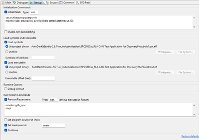

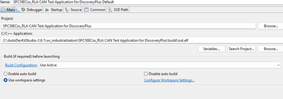

2025-11-20 12:50 AM - edited 2025-11-20 12:51 AM
Take a look also to MAIN, STARTUP and SVD path tabs.
I'll share an example for reference:
-Project pointing the correct "project explorer" file (the demo needs to be in the workspace, already compiled)
-C/C++ application pointing to the .elf file of your demo (into C//autodevkit_X/workspace_X/yourdemoname/build/out.elf)
MAIN tab:
Startup tab:
SVD tab (pointing to the SVD file corresponding to your micro)
Then:
