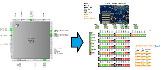

The section you are referring to explains how to modify the MCU pins to use in projects.
If you just want to use the AutoDevKit Studio demo applications, you do not need to modify anything.
That's because the MCU is wired to the pins labeled on the BOARDVIEW and your System (C4MINI+BMSCCTX) already works.
(left MCU pin allocation corresponds to the right pins of the connectors)
AutodevKit gives you the possibility to create custom projects with different pin configurations.

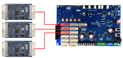

To be clearer, if for example you may want to create a new BMS project with 3 AEK-POW-BMSCCTX, connected to your C4MINI; you may (starting from our ready to use example) configure MCU pins to reach this:
Then AutoDevKit generates the code needed to configure your micro.
This approach is 50 times easier than configuring MCU registers manually. In case you don't know, SPC58x MCUs have 2000 pages manuals, and our configurable windows avoid you to study it.
