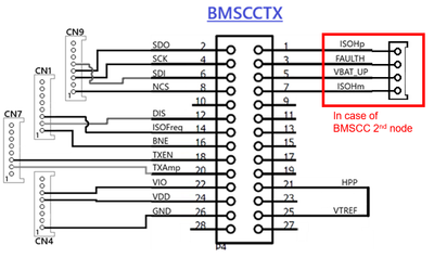

3) No. ISOH/ISOL are used to establish ISOSPI communication with another BMS board (AEK-POW-BMSCC).
This way you can connect up to 31 BMS boards in daisy chain, driving them with the same MCU board.
(2xBMS Nodes: AEK-POW-BMSCCTX + AEK-POW-BMSCC example)
Considering you have just 1 node (BMSCCTX) you can leave these pins floating.

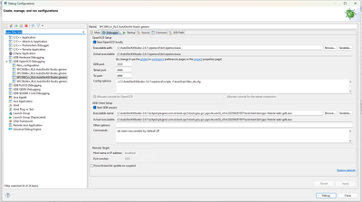

I am having the issue of flashing the project to the C4MINI mcu (I have shared the issue in the attachment). Can you share what all steps you did for successfully completing the flashing process.

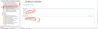

Disabled the cells we werent using, went down and changed the voltage levels to fit our cells. We didn't touch any other settings. After we did that we saved the project, pressed on "ALOCATE PINS", generate application code and compile application.

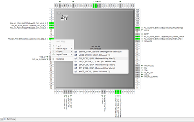

After which we went into PinMap editor, unassigned all of the allocated pins and opened a new application and copied the pin layout from the pre-built project there, making sure that while selecting the type of the pin(input,output, or I/O) select the coresponding type of the pin and their correct settings as shown below:
Generate, compile and go into debug- and debug. Should work now. Make sure all connections are correct. Also make sure to go into Board View and double check if all the pins on the MCU board are applied correctly.

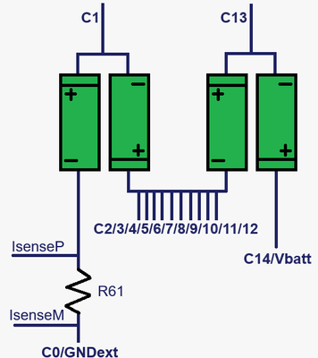

Hi Gabrijel,

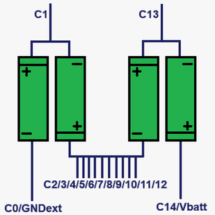

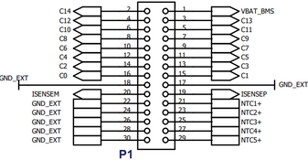

It seems there are 2 main issues in your HW configuration, let me guide you through the correct settings:
1) "less than 14 cells" battery packs requires ad-HOC wiring
L9963E (BMSCCTX core IC) requires at least 4 batteries to work properly, but batteries have to supply C0/C1/C2 - C12/C13/C14 BMS pins.
This means that the correct HW wiring for a 4cell battery pack is the following:
In case you want also to measure pack current, then you should mount R61 and add Isense wires as follows:
R61 value shall be set via SW in the configurator (default demo value=100ohm)

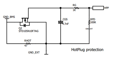

2) CLK behavior suggest no GND reference
This happens due to the HPP section (Hot plug protection) displayed below
HPP pin needs to be wired to one of the 2 reference voltages (VREG or VTREF) to assure ground continuity.
This should be your P4 configuration (heading to your C4MINI, assuming you are using the project: AEK-MCU-C4MINI - AEK_POW_BMSCCTX_GUI_application for discovery).

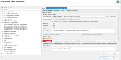

C: AutoDevKitStudio-2.6.1\eclipse\plugins\com.st.tools.spc5.tools.gnu.gcc.ppcvle.win32_4.9.4.202504281937\toolchain\bin\ppc-freevle-eabi-gdb.exe
I think we had to re-select the same file, after that it worked (:

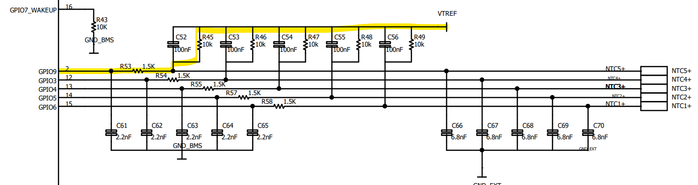

I have a few questions regarding wiring for unused gpio-s and current sense.
1. We are not using any NTC sensors right now as we have none (we just want to measure voltage for testing purposes), does that mean that we have to short all GPIO (3,4,5,6,9) to GND, or is just one enough?
Also to which pin can i short to GND? Can i just short it to pin GND_EXT?

1) Actually, the L9963E datasheet paragraph you are pointing (6.10.2) make no sense on the current HW implementation. (AEK-POW-BMSCCTX).
If you look at the AEK-POW-BMSCCTX schematic:
GPIO3-4-5-6-9 are pulled-up to VTREF. No ground connection is required. You have to leave NTCx pins floating.

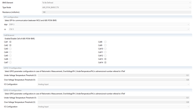

2025-11-24 7:42 AM
Dear Simone,
Thank you very much for your reply. Everything makes a lot more sense now!

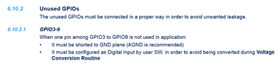

I just want to confirm that for the Isense resistor you mean we should use 100 mili OHM resistor? In the datasheet and in SW(AutoDevKit) it says the resistance is in miliohms. (See attached)
Also please note at the same picture, if GPIO is not used, do we just leave it on Analog Input, or do we change it to Digital input? (Please look at 6.10.2.1 in L9963E datasheet)

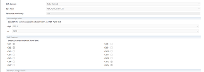

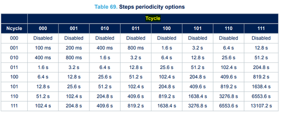

Also we couldn't find any explanation in the datasheets or in AutoDevKit regarding the following settings:
We understand that they are sample times, but what is the difference between N cycle GPIO Thermal and just GPIO,
is there a table or datasheet explaining what each variable means? We would love to know what each variable does.

2025-11-25 2:13 AM
Hi Gabrijel,
Yes, you are right, the rshunt default value is 100milli ohm.
Regarding GPIO mode, it is better to set every unused GPIO into digital input mode (this way the IC wont' perform the voltage conversion procedure referred to that GPIO)
Ncycle and Tcycle are values that may span from 000 to 111.
The table you see in the BMS component allow you to set a specific timing for BMS cyclic conversion routine.
Based on the intersections of these 2 values you select the routine duration.
Tcycle = time of cycles Ncycle = number of cycles
You can individually change the duration of some routines. In particular:
Tcycle_sleep: (used only when the IC is in cyclic wakeup, else Tcycle is used)
Ncycle GPIO thermal: *errata GPIO term, should refer to "GPIO terminal open" periodicity.
Ncycle cell thermal: *errata CELL term, should refer to "cell terminal open" diagnostic periodicity.
Ncycle GPIO: Refferred to GPIOs, the intersection with Tcycle define the ADC voltage conversion period.
Ncycle HWSC: Referred to HardWare Self Check, performs a BIST periodically, which trigger Configuration Override when a fault is percieved.
Ncycle Bal term: Referred to cell Balancing, balance terminal OPEN diagnostic periodicity.
For further information take a look to L9963E Datasheet

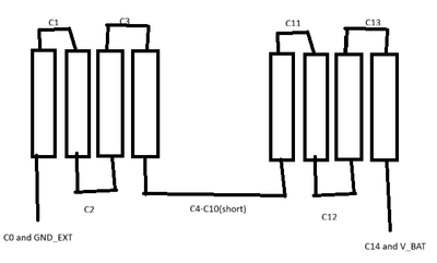

2025-11-25 10:17 PM - edited 2025-11-25 10:18 PM
@SRomeo @ritehracingteam I am trying to use 8 cells in BMSCCTX . As per Romeo's instruction, i connected the cells to the bms.
This is how i connected I shorted C4,C5,C6,C7,C8,C9,C10. I also shorted Isense+ and Isense- to GND_EXT as i am not using that.
When i connect this to my battery pack D2 lights up for only 1 min and then turns off. When i reconnect once more , same thing happens. Is there any wrong in the connection?
