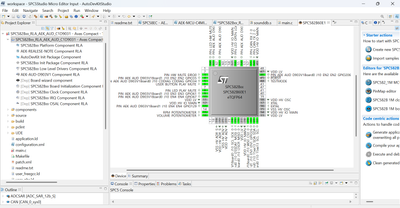

We have a SPC5 Studio IDE / AutoDevKit IDE - https://www.st.com/en/embedded-software/stsw-autodevkit.html
Many Sample project
Has graphical pinmap editor to configure the MCU pins.
SPC582B-DIS has built in UDE Debugger on board. You can install PLS UDE Software to connect directly to board.
There is a UDE folder in each sample project which you can use to open a debug.wsx workspace in PLS UDE Software after you compile the project.
