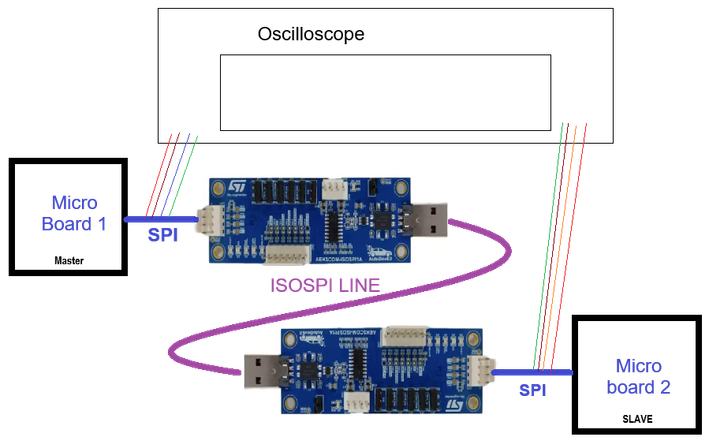

Let me help you checking what's wrong.
Use the scope to check SPI signals before and after ISOSPI transmission:
Compare those signals.
If the Signals are coherent, I think you have to adjust SPI software configuration of your Micro board n 2, because what changes is how each micro boards encode/decode data.

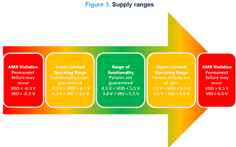

You can also try to monitor L9963T current absorption, checking if supply range fits the "range of functionality"
Anyway, I suggest taking a look to L9963T datasheet to check if you are encountering some edge cases.

2025-09-05 4:22 AM
Measured voltages with oscilloscope, dont see any glitches.
VDD=4.89VDC
VIO=3.33VDC
That would be in green working condition.
