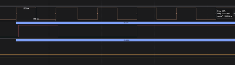

2025-09-04 12:43 AM
OK, i tried to send data from uC to encoder. And i get messy data at encoder side too.
I send data from uC 0x8080 and i get data to encoder 0x8181.
Encoder gives me reply 0x8100 and i get data to uC 0x0100.
I send data 0x8080 from uC every 80us. Then i receive same incorrect data to encoder side 0x8181 every time.
Encoder gives me reply data 0x8100 every time. I get incorrect data to uC (0x8080, 0x4100,0x8000,0x8180, C100, 0x8100,....)
See example from logic analyzer for one cycle.

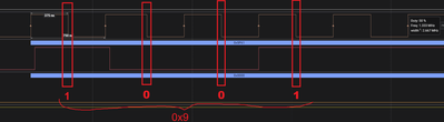

Hi Frank,
As I see from this screen:
you are decoding your SPI data on CLK Rising edge (which is wrong)
In this specific example, if you decode on CLK Falling edge, the decoded data will be the following:
So, based on what you expect, you should adjust the configuration of your analyzer.
There seems to be no problems on the signals whatsoever.
I suggest you to check also the SPI configuration of your micro board, making sure data decoding are consistent
Best regards,
Simone Romeo, AEK Team
