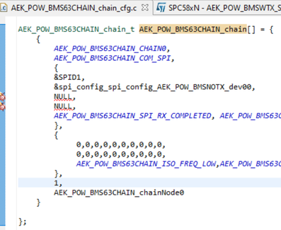

What should change from the demo application (apart from pin allocation) is just the following data field:
AEK_POW_BMS63CHAIN_node_num = 2
Please note that when a modification on a config file is done, you need to "save" and then "build" by using the Hammer icon (or else the code rerolls back to the default configuration)
