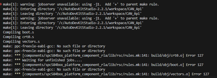

I'm trying to build SPC5 application in VS Studio Code on an agent environment (Windows), which does not have any installed SPC5Studio with Autodevkit plugin. The intention is to start a pipeline on AzureDevOps, where the project can be compiled and build on the agent environment.
While executing the command make -j8 all, I'm getting following error:
I ran this on VS Code with msys64 installed on windows pc.
@Erwan YVIN can you support me on this?

Hello ,
The compiler is in an eclipse plugin
Example
c:\SPC5Studio-6.0\eclipse\plugins\com.st.tools.spc5.tools.gnu.gcc.ppcvle.win32_4.9.4.20200908161514\
Autodevkit has the same
you can take it.
we have a linux version too
Best Regards
