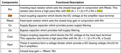

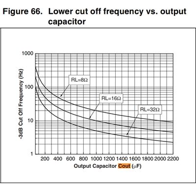

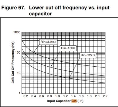

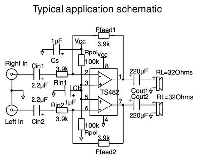

Hello @Kenny03
You can find her the values of the Input coupling capacitor (Cin):
And the values of the Output coupling capacitor (Cout):
Also, you have a typical application schematic that you can use:
For more details, refer to the this document .
Best regards.
II
