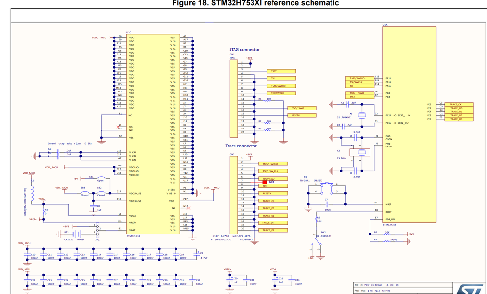

You may need to refer to the AN4938 "Getting started with STM32H74xI/G and STM32H75xI/G MCU hardware development":
A reference schematic:
So,
1- I don't seen any of the decoupling capacitors on VDD in your schematic
2- VCAP pins need only 2 x 2.2uF. Not one cap per VCAP pin.

Hello @RIVR and welcome to the ST community,
So,

Coming to your points:
1- My bad, I didn't realize I cropped off the decoupling caps from the snapshot. Decoupling caps are actually there, as per attached capture.
2- Ah, noted, I overlooked this. Will save one 2.2uF in my next re-spin then, thanks!
