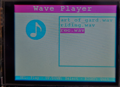

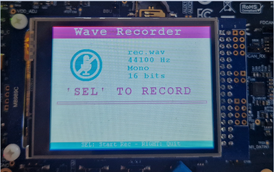

I'm afraid I don't understand your explanation. Are there 2 microphones on the card ? Why wouldn't the demo example work ? I have this picture for recording :
And for reading :
I can hear noises but not the sound from my microphone probably I don't know where exactly the second microphone is (if it exists?).
After a little research there are actually 2 MP34DT05TR digital microphones on the board. When I plug in my headphones and talk I can hear my voice back. But it isn't this example that I'm trying to make it work but the 'demo' example of the evaluation card.
