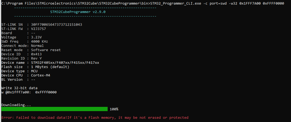

2022-03-04 3:57 AM
I tested it, but it still doesn't work.
STM32F407IG and ST-LINK V2. Verified by reading the lock bytes afterwards - nothing changed.
Kind regards,
Peter

2022-03-06 10:25 AM
Hello @PZuid.1 ,
You are right ! the issue is fixed in 2.9.0 only for F4 0x458 device ID.
Issue still exist for 0x413 and will be fixed in future release.
Meanwhile I will send you the patch via private message.
Hope this helps you.
Houda
