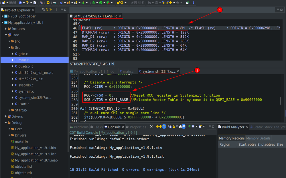

I have a simple code in file main.c of my testing application.
/ * User Code Begin While */
While (1)
/ * User Code end While */
/ * User Code Begin 3 */
Counter ++;
Printf ("Hi from QSPI and Counter = \%D \ N", Counter);
Hal_gpio_togglepin (PE3_GPIO_PORT, PE3_PIN);
Hal_Delay (500);
/ * User Code end 3 */
}And also performed a few steps:
1. Reset RCC register in SystemInit function (file system_stm32h750xx.c) RCC->CFGR = 0;
2. Relocate Vector Table in my case it to QSPI_BASE = 0x90000000 SCB->VTOR = QSPIBASE;
3. Linker script configured according size of my chip, see screen.
QUESTION: Is this enough for the correct launch of my testing application from the external QSPI?
2022-07-14 8:40 AM
From the application side I would avoid reseting or touching the RCC for the most part. Specifically you really don't want to be tearing down the clock sources, PLLs, or reconfiguring or touching anything related to the QSPI.
For example not DeInit'ing the GPIO bank(s)
Contractually you want ALL the system bring-up on the Boot Loader side, ie the clocks the PLL, the system critical pins, etc. The things you will use all the time, and would facilitate system updates and recovery.
You don't have to bring up UART, SPI, I2C that the loader doesn't use. And generally you don't want a lot of interrupts, as these will complicate the hand-over.
The SystemInit() on the App side needs to be relatively lean, perhaps enable the FPU, and assign the new operational SCB->VTOR
2022-07-14 8:52 AM
Yes, the Linker Script (.LD) looks to be Ok,
The origin has to be aligned to a 512 byte boundary, but can be deeper into the QSPI provided the Loader and App have a consistent understanding of where it is.
Here I use a symbolic link to set the VTOR, and I also load the SP in my Reset_Handler, as this also reduces the complexity of the hand-over, and compiler issues related to changing the stack pointer, and then referencing local/auto variables.

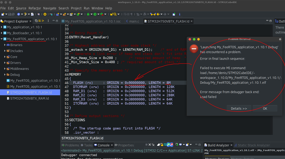

2022-07-15 11:31 PM
Thanks for your comments, finally everything worked!
And now I have a new problem, If the application is implemented using a FreeRTOS!
If I change the linker script, the application is not compiled, see screen.
How to configure FreeRTOS application for external boot by QSPI?
