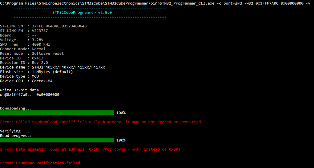

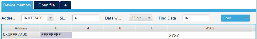

2020-12-26 4:33 AM
Hi @Houda GHABRI
I think it was just a copy paste error while writing the question.
I repeated the test with the correct address 0x1FFF 7A0C and the result is the same as last time.
I have attached two screenshots.
The first one shows the write of 0x00000000 to lock block 0x1FFF 7A0C using the ST Link CLI programmer:
The second one shows the readout of the flash memory address 0x1FFF 7A0C after the failed write attempt:
