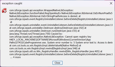

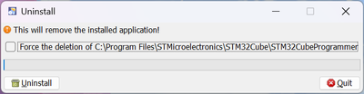

Whether or not I select "Force the deletion of ...", when I click "Uninstall," I get an unhandled exception pop-up (I can't find a way to copy the text out of it, sorry), which appears to indicate Access Denied when trying to modify registry keys:
My company uses a credentials manager to provide admin privileges as needed when installing and uninstalling apps, and it asked if I wanted to escalate my privileges in both cases (running the uninstaller and running the script directly), but it said the software publisher was "Unknown" as if it didn't install correctly or wasn't signed.

I could only reproduce the issue you're seeing if I was running the uninstaller with insufficient privileges. With admin rights, everything worked as expected. So could you please check with your company IT team to make sure you have sufficient privileges ? STM32CubeProgrammer is properly signed.
