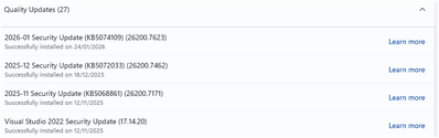

Which exactly update do you suspect? The recently installed updates can be seen in the Settings app:
If your computer is managed by a company's IT, please ask them what have they changed recently.
2026-02-01 11:06 PM
Those are the last 2 updates that were installed:
2026-02-03 1:23 AM - edited 2026-02-03 1:27 AM
Hi @LMenc.1 , search shows that the problem likely is caused by KB5074105:
