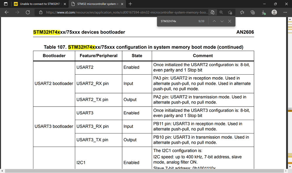

You need use exact pins and config described in AN2606 for example
2022-06-12 10:49 PM
Hi, thanks for the response. I did use the mentioned pin for USART1 - PA9 and PA10 from AN2606. The same set of pins were working on the Nucleo, but not in our custom board.

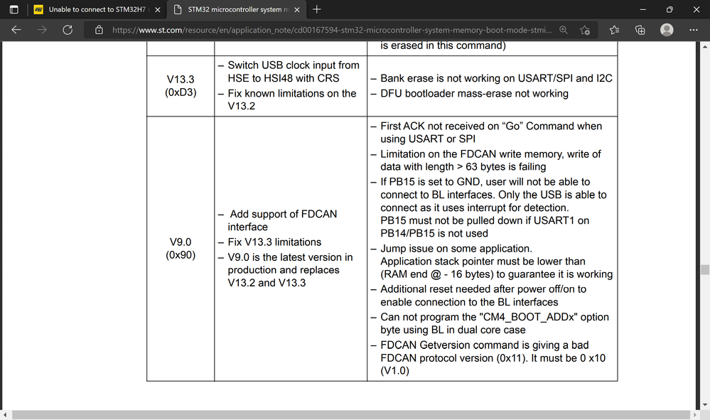

You meet all this
2022-06-14 4:19 AM
The PB15 was set to GND in our case. And changing it, solved our issue. We are able to connect to the bootloader now. Thank you very much.
