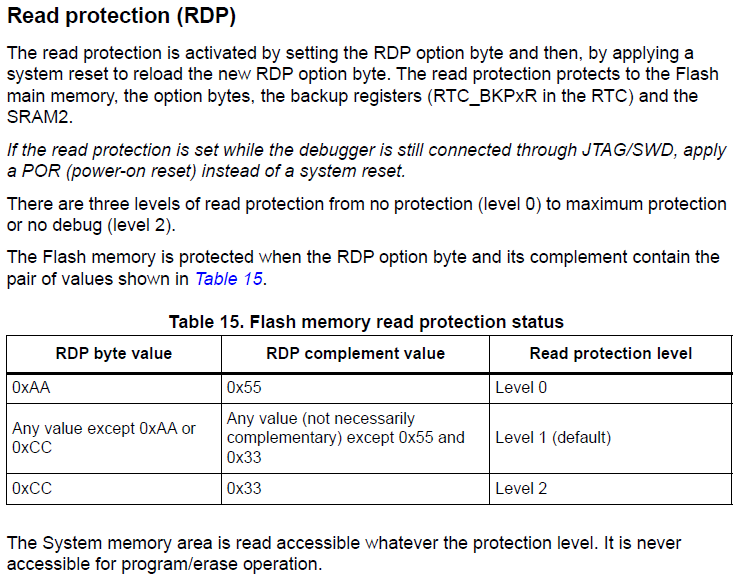

I did wonder whether this is because the Read Out protection for STM32L4R is set to 1 from the factory? But again, I tried to revert the option bytes to factory after which I cannot read the flash memory again before setting it back to Level 0.

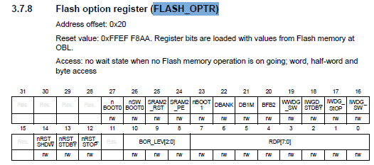

But if I connect a new and unprogrammed board to the ST Link V2 Utility it shows me all the memory content. I also saw that the reset value of the FLASH_OPTR register for the readout protection level is set to 0xAA.
However, datasheet also says that default value, I am assuming factory programmed is Level 1.

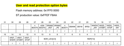

it mentioned, in RM0432 User and read protection option bytes paragraph : Flash memory address: 0x1FFF 7800 (corresponding to OPTR option register) ST production value: 0xFFEF F8AA. Therefore the RDP programmed by the fab is 0xAA meaning RDP level 0.
For FLASH_OPTR reset value, I will check internally.
CDM0061548 (This is an internal tracking number and is not accessible or usable by customers).
