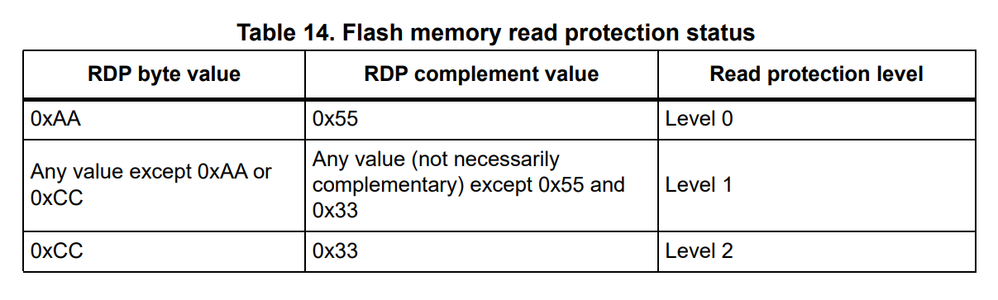

2021-02-28 2:21 PM
Hi @RHaag.1 ,
You can refer to table 14 in RM0351 3.5 Flash memory protection :
Houda
2021-03-02 3:47 AM
Hi Houda,
it's a valuable discussion, but I still don't know the RDP value when the comparission doesn't match. I know it can be "my" 0xFF, but I'm quite sure ST implemented a certain value in this case not a "could be anything except..." :)
Regards
Ralph
