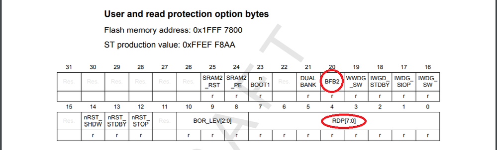

2021-02-23 7:19 AM
Hi @RHaag.1 ,
For RDP default value is 0xAA (as you can see in the snapshot I sent you the ST production value is 0FFEF F8AA).
Can you please tell me what do you mean by the "inversion data mismatch" in OBs? it is not a known notion for me.
Houda
2021-02-23 11:26 PM
Hi Houda,
RM0351 3.4.2 Option bytes programming says:
If the comparison between the word and its complement fails, a status bit OPTVERR is set.
Mismatch values are forced into the option registers:
For RDP option, the value of mismatch is the default value “Level 1�?
The 0xAA you mention is the RDP reset value leading to "level 0", but which value in is forced to the RDP regs in the described mismatch case leading to "level 1"? Can't find it in the ref manual.
