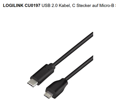

EDIT: This Adafruit USB C to USB Micro cable description states "Internally it has a 5.1Kohm pulldown, to make the USB C port configure itself for 5V, 500mA USB 2.0 standard," what is the pulldown on? I'm going to purchase this cable and see if I have better results, perhaps the adapters are trying to run at USB 3.0 speeds instead of USB 2.0.
https://www.adafruit.com/product/3878
EDIT2: For anyone else that might be having this problem, a USB C to USB Micro cable (no hub/adapter) fixed the issue for me and the device identifies correctly now.

try a USB-C -> micro-B cable , like this :
ed
Yes, the Adafruit USB C to USB Micro seems similar , try it.
ed

I'll get one of those cables and see if it helps, and see if there's a way to pullup to 3.3V instead.
