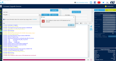

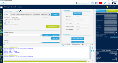

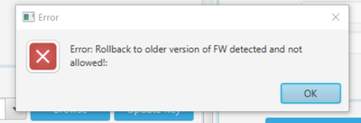

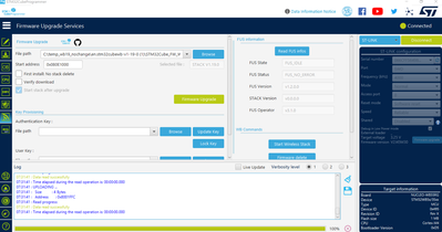

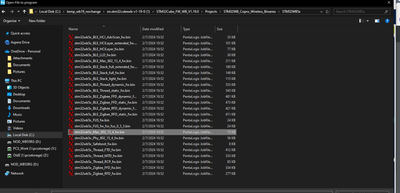

2024-05-10 4:40 AM
Hi STTwo-32,
This is the screen shots.
1. showing the FUS info
2. The FW i did select
3. before the FW upgrade click
4. After FW upgrade click
2024-05-10 5:52 AM
I think you have activated the Anti-rollback without ensuring that a wireless stack is correctly installed. If so, the FUS registers 0xFFFFFFFF as the new version, and it is not possible to install a wireless stack. So, no firmware update is allowed after that, and no recovery is possible at this point. For more details about Anti-rollback activation, I suggest you take a look at the part 2.4 of the AN5185.
