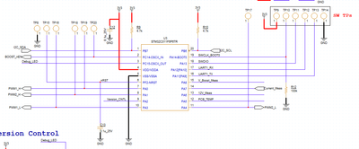

2025-12-09 1:41 PM
NRST low could indicate power issue or other serious design issue. Is VDD stable 3.3V? NRST low and not toggling? Use a scope rather than multimeter. Can try booting to bootloader to recover. See AN2606.

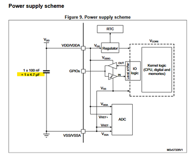

2025-12-09 1:49 PM
Do you have a 4.7 uF capacitor?
