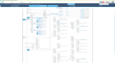

Hello @Badrinathan
I compared the two provided IOC files and identified the key differences in the clock configuration:
Without RNG:
The PLL is enabled and used as the system clock (SYSCLK).
MSI is selected as the PLL source.
SYSCLK is derived from the PLL, resulting in a higher system frequency.
Voltage scaling is set to SCALE1, providing the highest performance.
With RNG:
HSI48 (the 48 MHz internal oscillator, required for TRNG) is enabled.
The PLL is disabled (PLLState = RCC_PLL_NONE).
SYSCLK is sourced directly from MSI, not the PLL, leading to a much lower system frequency.
Voltage scaling is set to SCALE3, which is the lowest performance setting.
Recommendation:
To ensure both RNG and SPI2 function correctly, enable HSI48 for the RNG peripheral while maintaining your original PLL-based system clock and high-performance voltage scaling. This configuration will allow both peripherals to operate at their required speeds.

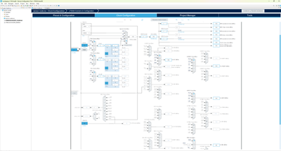

2025-11-17 5:28 AM - edited 2025-11-17 5:34 AM
Hello @Badrinathan
Here are the steps I followed: I used CubeMX 6.16.0 standalone and loaded your IOC file (sensor node without TRNG.ioc). I kept your original configuration, then activated the RNG and ensured that HSI48 is selected as the input for the RNG multiplexer. Afterward, I generated the code and chose STM32CubeIDE as the toolchain.
I will review this in STM32CubeIDE and get back to you.
2025-11-17 5:44 AM
Hello @Badrinathan
Inside STM32CubeIDE, import the attached IOC
Then generate code

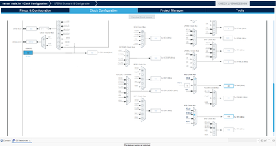

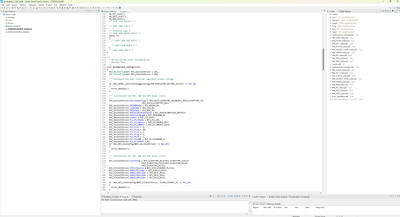

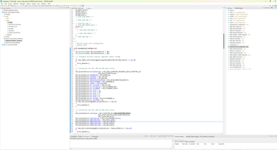

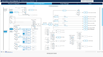

2025-11-17 9:26 PM - edited 2025-11-18 4:05 AM
Hi @Ghofrane GSOURI
After enabling the TRNG and selecting HSI48 as its clock source, CubeIDE automatically changes the SPI2 clock source from PCLK1 to SYSCLK, which causes SPI2 to fail.
Even when I manually switch the SPI2 clock source back to PCLK1, the issue persists and SPI2 still does not work.
parameters' also changing automatically.
Please find attached the clock configuration on snippet and the IOC file with the TRNG enabled.
void SystemClock_Config(void)
if (HAL_PWREx_ControlVoltageScaling(PWR_REGULATOR_VOLTAGE_SCALE1) != HAL_OK)
Error_Handler();
RCC_OscInitStruct.OscillatorType = RCC_OSCILLATORTYPE_HSI48|RCC_OSCILLATORTYPE_LSI
|RCC_OSCILLATORTYPE_MSI;
RCC_OscInitStruct.HSI48State = RCC_HSI48_ON;
RCC_OscInitStruct.LSIState = RCC_LSI_ON;
RCC_OscInitStruct.MSIState = RCC_MSI_ON;
RCC_OscInitStruct.MSICalibrationValue = RCC_MSICALIBRATION_DEFAULT;
RCC_OscInitStruct.MSIClockRange = RCC_MSIRANGE_0;
RCC_OscInitStruct.LSIDiv = RCC_LSI_DIV1;
RCC_OscInitStruct.PLL.PLLSource = RCC_PLLSOURCE_MSI;
RCC_OscInitStruct.PLL.PLLMBOOST = RCC_PLLMBOOST_DIV4;
RCC_OscInitStruct.PLL.PLLM = 3;
RCC_OscInitStruct.PLL.PLLN = 10;
RCC_OscInitStruct.PLL.PLLP = 2;
RCC_OscInitStruct.PLL.PLLQ = 2;
RCC_OscInitStruct.PLL.PLLR = 1;
RCC_OscInitStruct.PLL.PLLRGE = RCC_PLLVCIRANGE_1;
RCC_OscInitStruct.PLL.PLLFRACN = 0;
Error_Handler();
|RCC_CLOCKTYPE_PCLK1|RCC_CLOCKTYPE_PCLK2
|RCC_CLOCKTYPE_PCLK3;
RCC_ClkInitStruct.APB2CLKDivider = RCC_HCLK_DIV1;
RCC_ClkInitStruct.APB3CLKDivider = RCC_HCLK_DIV1;
if (HAL_RCC_ClockConfig(&RCC_ClkInitStruct, FLASH_LATENCY_4) != HAL_OK)
Error_Handler();
