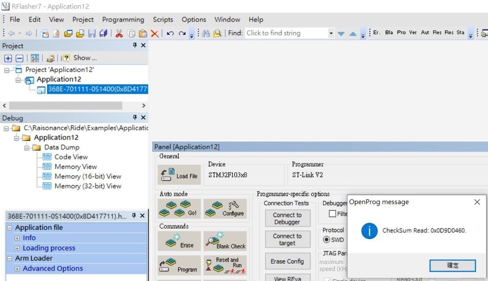

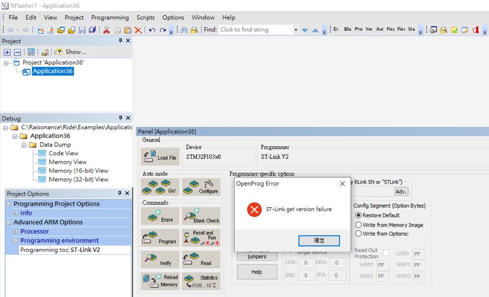

Hi
It's just that something strange happened to me
If I use RKit-ARM 1.68.18.0108 I get the following CheckSum "D9D0460"
But if I upgrade RKit-ARM to 1.72.19.0253, there will be a version error problem
But 1.72.19.0253 is to fix the problem of CheckSum display, so I have this dilemma now
