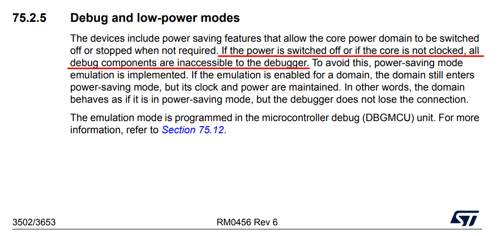

Indeed: the debug is not accessible during Stop:
via: https://www.st.com/en/microcontrollers-microprocessors/stm32u535cb.html#documentation
Also, it's common to disable the debug pins (to save power) during low-power modes.
So you need to wake-up out of STOP before you can do anything with the debugger. A reset achieves this.
@Decebalus wrote:adding a delay at the start of the program to give myself time to program the device after a manual reset?
That can be useful.
As the above screenshot says, There are also "emulation" options which allow the debug to remain active during low-power modes, but I don't know how you'd access them from VSCode. And, of course, you don't achieve the low power with these enabled!
