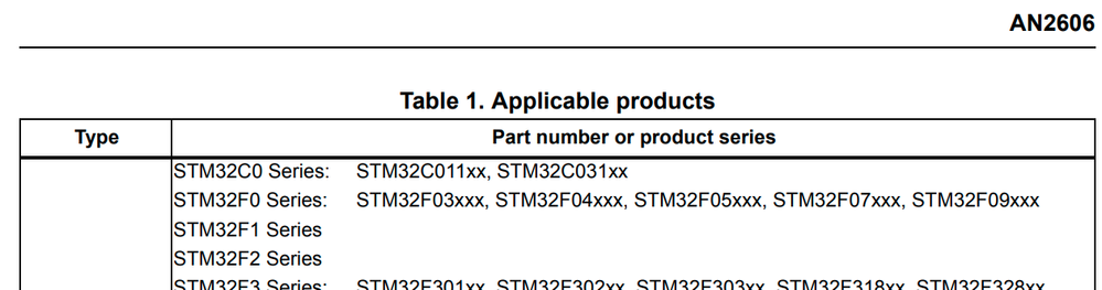

My main application which highly relies on USART1 works as expected. So I don't think there is an issue with the USART pins or PCBs I've used. STM32F103 is not listed in AN2026 AN2606, so is there any chance that particular model doesn't have a ROM bootloader?

> STM32F103 is not listed in AN2026, so is there any chance that particular model doesn't have a ROM bootloader?

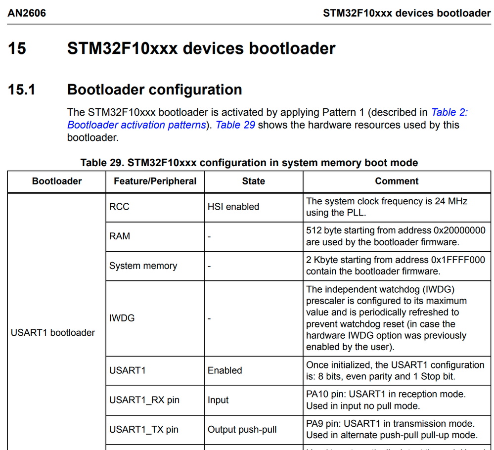

You mean AN2606? I think "STM32F1 Series" means it applies to all STM32F1 chips.
In any case, the various STM32F1 bootloaders are in the document.
Are you using the pins listed in the document?
