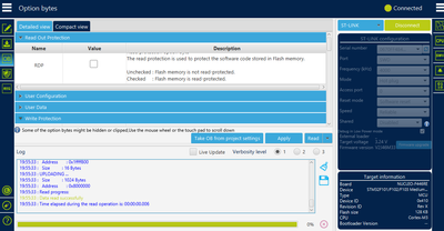

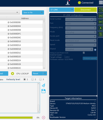

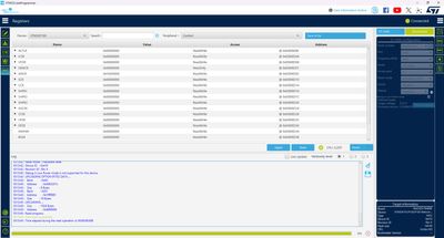

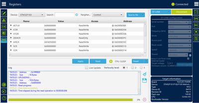

ı use stm32f446re nucleo board as stlink,ı can not connect stmf103 with cubeide ,only with cubeprogrammer in hot plug mode,
this is the screenshoot ,only see stm in sleep mode , ı try my nucleo board and ı see halted,is there any chance my stm32f103c8t6 is clone

Everything could be a "clone" , but it is very unlikely , as cpu ID (and revision) show same, as on a F103 here:

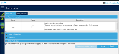

So connect with : software reset, nrst not needed;

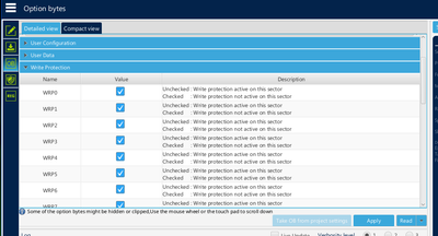

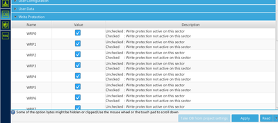

Then look in OptionBytes: rdp not set:
next see in OptionBytes: all (!) sectors have write protection OFF (= checked).
down to 31:

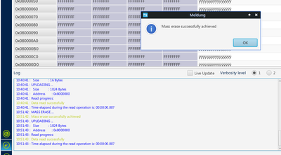

Then full/mass erase should work:
Try.

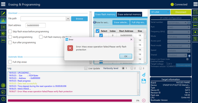

so when ı checked all option bytes click apply programmer stop working
these are screenshoot when ı try to full erase chip

And you looked at all sectors in OptionBytes ?
btw
I also got some new chips from distributor, that had some write protected sectors - no full erase possible.
Until you set all to unprotected.
