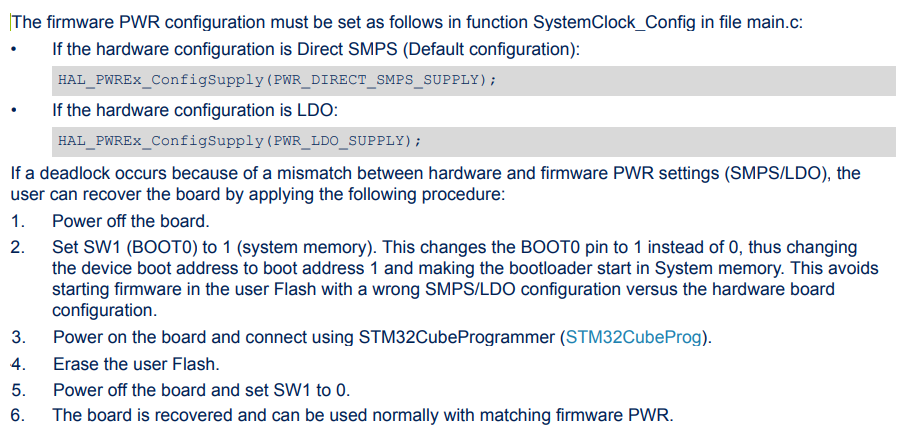

I read previous posts about H7 processors:
https://community.st.com/s/question/0D53W00000LeYL1SAN/get-stm32h735gdk-out-of-deadlock
https://community.st.com/s/question/0D50X0000BqBA6TSQW/error-to-connect-to-target-stm32h747idisco
https://community.st.com/s/question/0D50X0000Bh5aWoSQI/stm32h747-discovery-kit-not-debugprogrammer
I've also checked if the power configuration is set correctly:Neither of these solutions work. My code:
Yes, different problem, where no connectivity at all is possible, and it looks like you bricked the board.
Double check the build addresses in the linker script (.LD), and vector table / entries points in the .MAP file, or dumped from the .ELF file.
