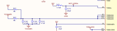

I have attached images of my configuration settings and schematics.
How can I resolve this issue? I have tried both Serial Wire and JTAG modes, but the problem persists.

Maybe i assemblied R32 before. I removed it and assembled to the R22. It is working now. I don't now maybe main reason it is.

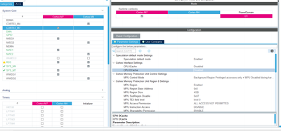

I activated cortex_m7 modes. It is working but I don't know how to adjust the settings here. What should I set this settings? I have no information about this part.
2025-02-25 6:36 AM
Why do you want to adjust things? There is no "correct" setting. They are there to allow customization based on your needs. If you have no idea, leave them alone at default.
If you want to know more about a particular item, the reference manual is a good place to start. A bit out of scope to explain everything here especially as it's not the issue related to being unable to connect.
2025-02-25 11:18 PM
Because when I activated mode settings, my main problem is solved. That's why I asked this settings.

I don't see what is your power configuration SMPS or LDO according to these schematics:
VDDLDO connected to VLXSMPS?

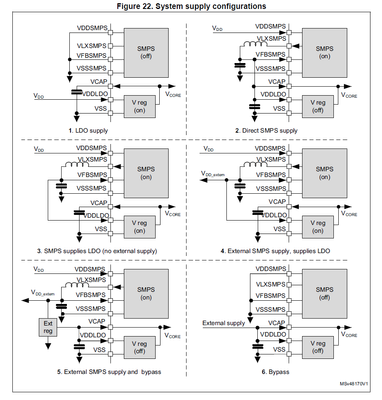

@KAnahar wrote:
From the reference manual, these are the HW config for the different power configs:
The configs that connect VDDLDO to VLXSMPS is through an inductor.
So need to specify which power config you are using.
2025-02-26 3:58 AM - edited 2025-02-26 3:59 AM
VLXSMPS was connecting to the VDDLDO before. I remove this configuration and directly connected to 3V3 line. It is working now. I can upload code again and again.
