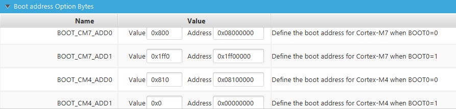

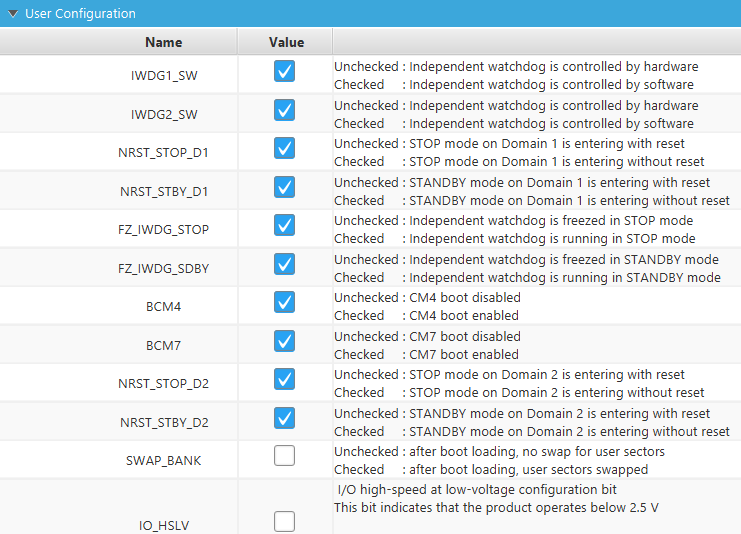

We've double checked the settings according to AN5361 (remember, it worked before anyways).
The option bytes (OB) are as follows according to CubeProgrammer:
