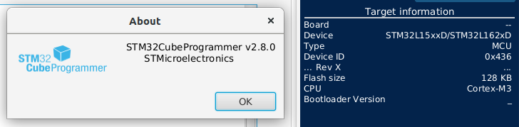

The STM32L152VT6X has 384KBytes of flash memory, but the STM32CubeProgrammer detects the flash size as being 128KB. When I try to flash an image of ~170KB it fails with the error "Operation exceeds memory limits". When I flash the same image with the STLINK Utility it flashes successfully.
The first image is from the stlink utility and the second is from STM32CubeProgrammer

2021-09-20 12:12 PM
The issue still exists, I tested with v2.8.0 on Linux. See screenshot.

2021-10-08 4:07 AM
Hello @Houda GHABRI
i have replaced the xml file as described in your post. Now the Cubeprogrammer recognizes the flash size correctly.
But it's still not possible to erase, program or write OB. Reading out the entire memory works without any problems.
