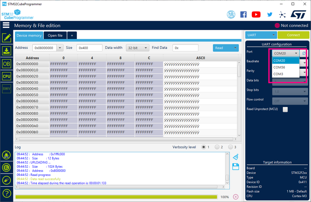

My next step is to disconnect NUCLEO-F207ZG board from the STM32CubeProgrammer and to select the UART interface (configuration is shown in the attached image) . When I click the Connect button, I get the following message error (see also the attached image):
Error: Activating device: KO. Please, verify the boot mode configuration and check the serial port configuration. Reset your device then try again...

To connect this NUCLEO-F207ZG board in bootloader mode via UART interface you need to :
-Make sure that Boot0 is connected to VDD and Boot1 is connected to GND
-Make sure to connect RX/TX pin , you can use PB10 (USART3 in transmission mod) and PB11 pin(USART3 in reception mode )
-Select the appropriate port
You can refer to AN2606 document for UART connection and Board schematic for pins .
