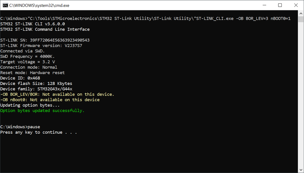

I was trying to set option bytes (BOR) with the ST-Link CLI (v3.6.0.0) for STM32G431, but it prompts that this feature is not available. With the ST-LINK Utility (v4.6.0.0) it is possible to set the BOR Level.
I guess the ST-Link CLI is no longer maintained and you have to switch to the new one (Cube Programmer CLI), is that correct?

Correct, the ST-LINK Utility is on status NRND (Not Recommended for New Designs) and should be replaced by the STM32CubeProgrammer (see a similar question here).
