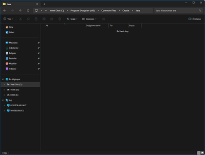

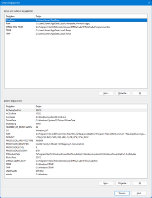

This is the situation on the PC I use.
I tried installing Windows 10 and Windows 11 on two different PCs without installing any programs, the result did not change, it remains at step 8. I think it might be regional or Windows language related.
